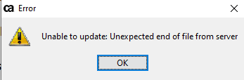

Attempting to update the portal integration components from policy manager->tasks->Extensions and Add-Ons->Update Portal Integration
was failing with the following error: Unable to update: Unexpected end of file from server
