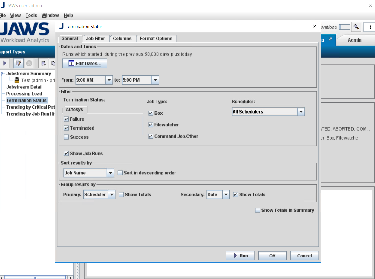

Keep in mind that the selection of statuses as well as dates when running termination report can also be an issue if a big amount of data is selected. For example, it is not recommended to put something like thousands of days for 1 report if it is a big system. Please see the screenshot below:
All unnecessary statuses should not be selected. In this example, 'Success' not selected (which is optional, just be aware it can be pulling too much data if a big time frame is selected for past runs). With such selection, there will be 50,000 days worth of data for termination status report. The more days put in, the more data report would try to pull out of the database, and that means long running query parsing through enormous amount of data, that can cause performance issues on AAI side.
