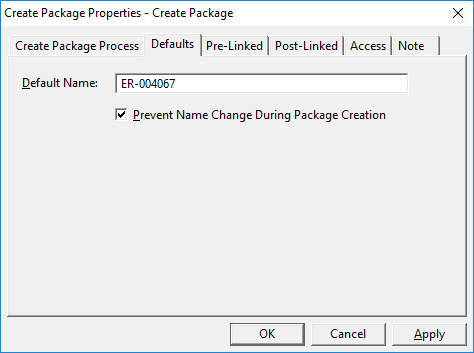

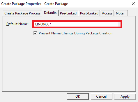

Your Create Package properties page looks like this:

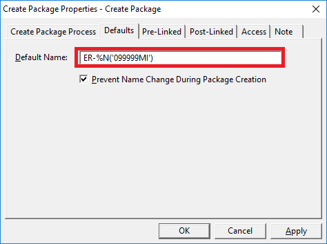

The “Default Name” field should show a pattern, not an actual number, more like this:
The reason to use a pattern rather than an actual value is that you don't want all your packages to actually be named "ER-004067", but instead you want the next package to be named "ER-004067" and the next one "ER-004068" and so on. You want the names to have sequential numbers and to be formatted following a pattern.
Here’s where the documentation is for setting up the Create Package process: Define Lifecycle Processes - Define a Create Package Process
There’s a section there called “How to Specify Default Package and Form Names” that explains how to set up the pattern you want to use in the “Default Name” field. If you want your package names to look similar to what you have specified, your Default Name field would be “ER-%N('099999MI')”.
