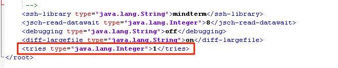

- Disable Device Retries (Many device login failures can greatly slow down the device processing as the default retry value is 3):
1. Navigate to $SPECROOT/NCM/ and edit the config.xml
2. Add the following parameter:
3. Kill\End Task the ncmservice.exe process to enable the new setting (processd will automatically re-spawn a new ncmservice process)
