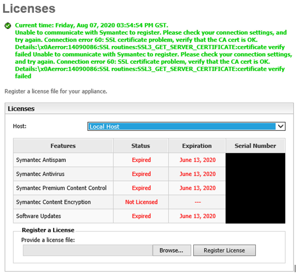

When trying to register the SMG License, the error: "Unable to communicate with Symantec to register. Please check your connection settings, and try again. Connection error 60:SSL certificate problem, verify that the CA cert is OK.
