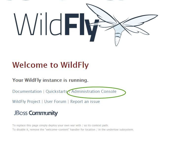

Login to the VNA Wildfly webpage:
http://YOUR-VNA:8080
And select Administration Console:

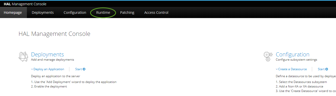

Select Runtime at the top:
Highlight the server name on the left, select status under monitor and hit view
And you can see the java heap and thread count in real time.
** If the used heap is above 60% of the max memory, you need to add more memory.**
