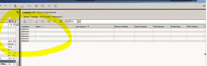

OneClick client console responsiveness is slow. For example, tables not updating and showing data in a timely manner or taking minutes to do so
