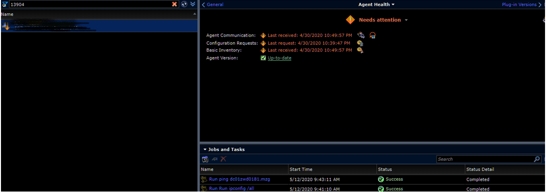

The Symantec Management Agent service is running on many machines, but it will not send Basic Inventory, or update the agent configuration even if the user manually clicks to send or update.
You have a couple of dozens of machines that their last time sending basic inventory or requesting configuration were days ago.
For example:
For the purpose of illustrating the process and what you may been seeing, lets say that you noticed the issue on May 12th. And the last time the agent was able to request configuration or send basic inventory was April 30th.

After April 30th, you don't see much activity coming from "AeXNSAgent.exe" in the agent logs.
If you restart the Altiris Agent (Symantec Management Agent) service, then things go back to normal:
  • Tasks seem to be running just fine even when the client machines are in "hang" mode.
  • Agent service is in a started state. It has been for many days.
  • Agent Service shows as connected.
  • Agent Configuration request and basic inventory dates do not change. The last date was one week ago.
