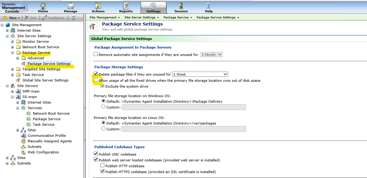

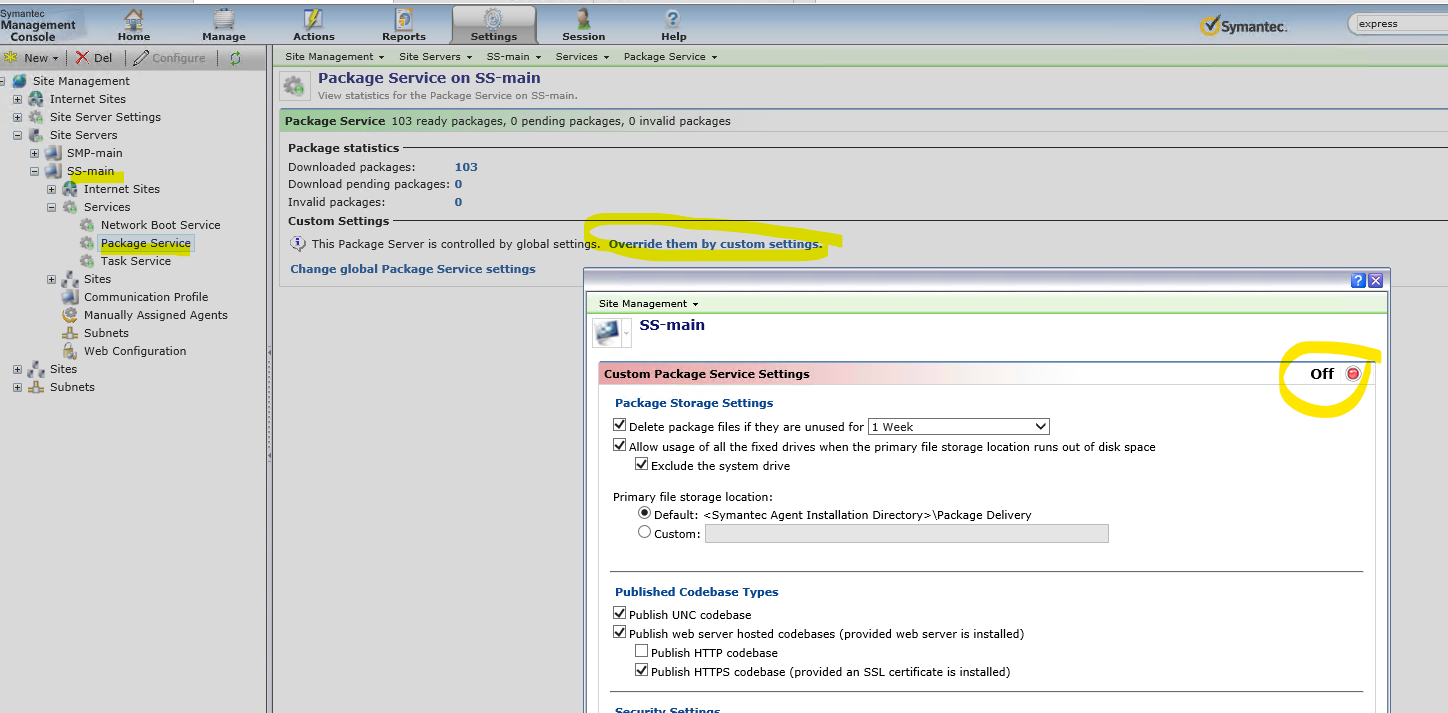

There is 85GB of space available on the drive with the main package share (in this case the D drive). Shares on the E and M drives keep getting created. Checked if there was a Custom Settings for the Package Service:
and made sure that the Global Package Service Setting has unchecked the "Allow usage of all the fixed drives when the primary file storage location runs out of disk space".

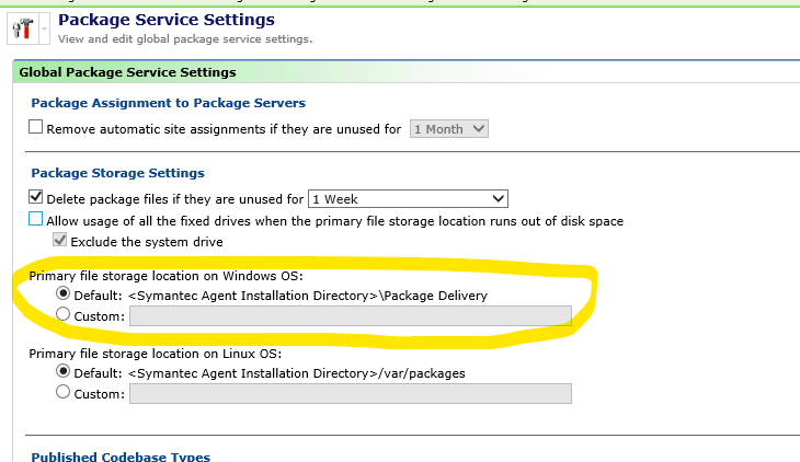

As far as we can tell, the customer is not using a "Custom location" for these packages.

The registry called "AllowFixedDrives" (under HKEY_LOCAL_MACHINE\SOFTWARE\Altiris\Altiris Agent\Package Server) was set to "0", which means PackageDelivery will not download to other drives except the default one. In this case it is "D".
