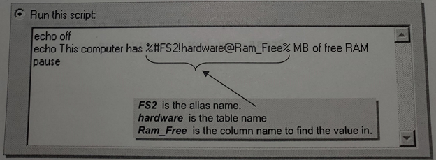

To give you a better idea of how this works, consider a Deployment Server (or GSS)
Job using the following Run Script Task:
echo off
echo This computer has %#FS2!hardware@Ram_Free MB of free RAM
pause
FS2 is the alias name.
hardware is the table name
Ram_Free is the column name to find the value in.
