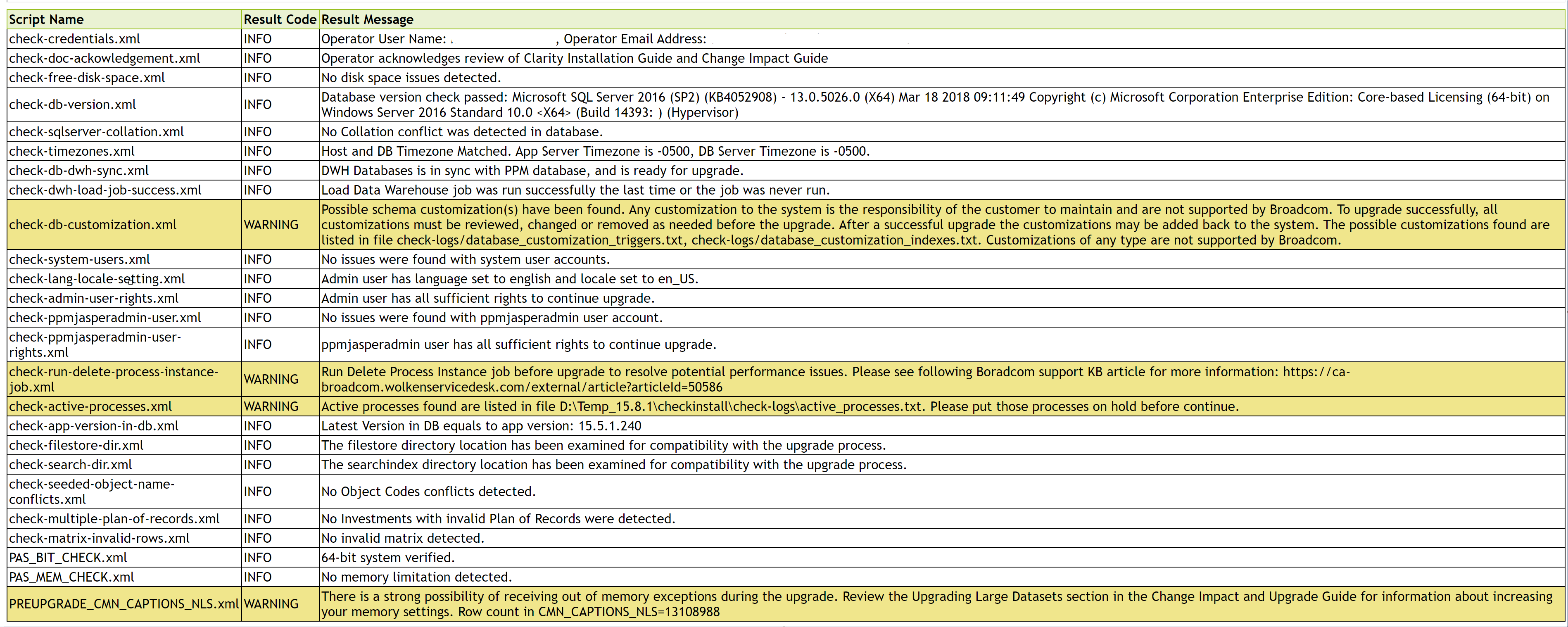

To read the results, open the the $install\checkinstall\check-logs\precheck-results.html file in browser. This will contain all the results and the actions you can take to remedy them. Example output:
If you have ERROR, you cannot proceed, and must address the issue before continuing with upgrade.
If you have a WARNING, you have the choice. Usually this will not cause a problem with the upgrade, but it might be an issue for just some customers. So on lower environment you may decide to ignore them and continue, or you can still go by the list and address them before continuing if you would like to do things per best practice.
