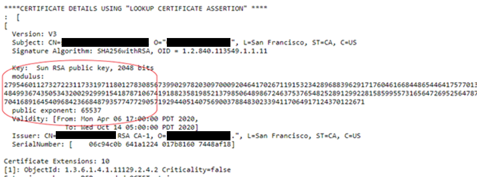

Example about Lookup Certificate Assertion . This will provide the modulus and exponent values. However, it does Not return in an easily parsable format (ie not JSON or XML).
You would need to create some custom policy to retrieve the values and encode them to the JWK standard.

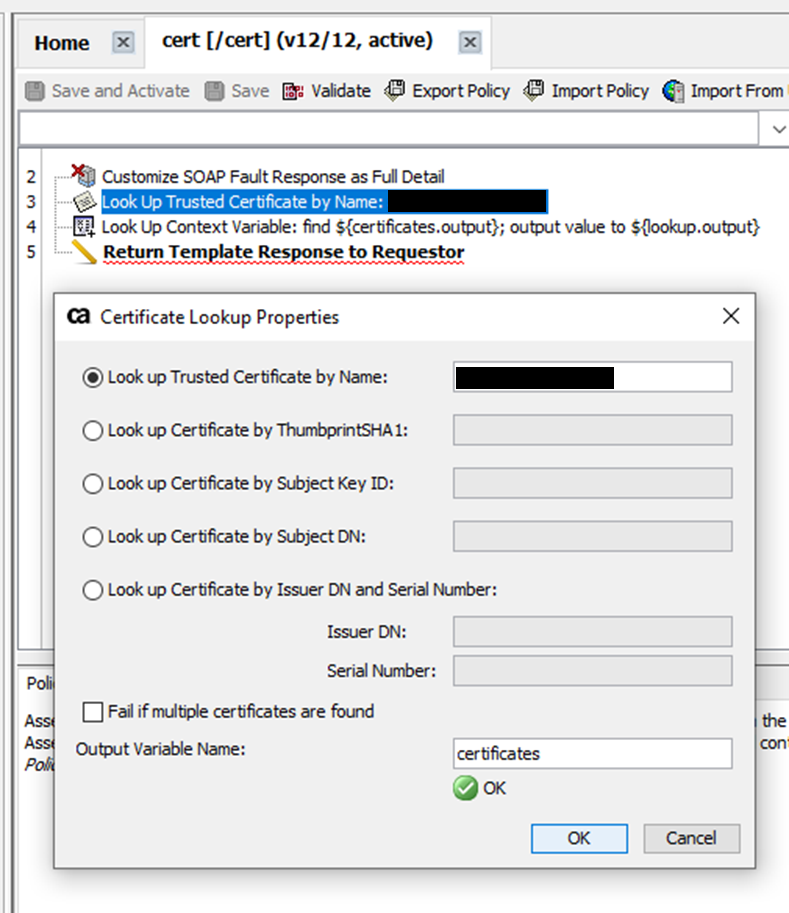

below a simple example about how to obtain the certificate info by using the Assertion :

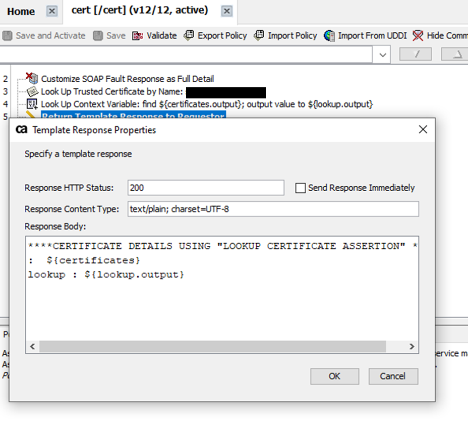

2. how to display the info on Output variable :
3. how looks the output from browser when using the certificate output variable..
