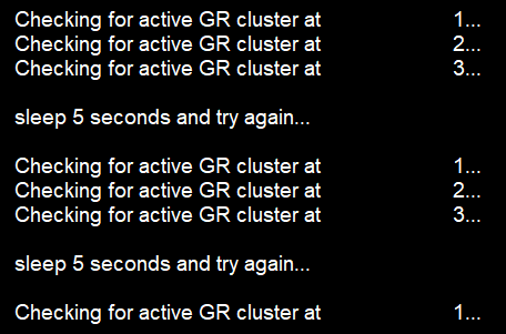

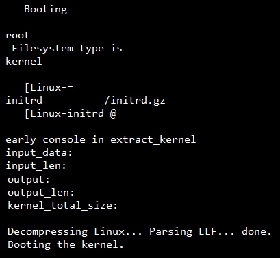

8. Reboot the node but only shows "Booting the kernel" and no activities.
* If you are seeing the node is trying to communicate with other PAM nodes after reboot, that is a good sign.
* Identify which node is not attempting to sync with other nodes and stays at "Booting the kernel".

Then those PAM nodes that is stuck at "Booting the kernel" need to be reverted to previous snapshot as the current state may already be in damaged state due to unexpected corruption.
You can take a DB export at this point from a working node in case if that need to be restored at the Primary site.
Once you revert the snapshot of the damaged node, it should try to sync up with other nodes and recover itself.
