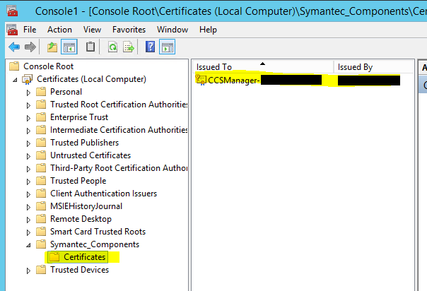

Back in the MMC console, expand Certificates -> Symantec_Components -> Certificates folder and it will display the certificate for that manager.
Double click on the CCSManager-<hostname> certificate and select the 'Details' tab.
The serial number for that manager is listed in the information. You can now compare that serial number to the serial number listed for that manager in the Certificate Management Console on the Application Server.
