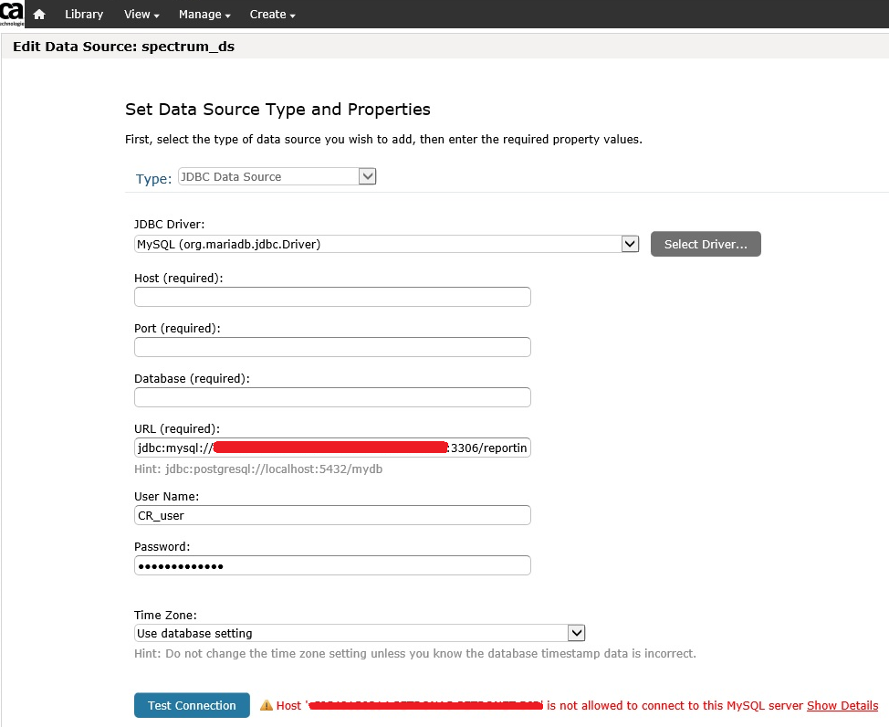

The CABI Server does not have permissions to execute queries against the Spectrum MySQL database server:

Testing the spectrum_ds data source in JasperSoft results in one of the following errors:
“Could not connect: Access denied for user 'CR_user'@'<CABI Server>' to database 'reporting'"
“Host '<CABI Server>' is not allowed to connect to this MySQL server”.
