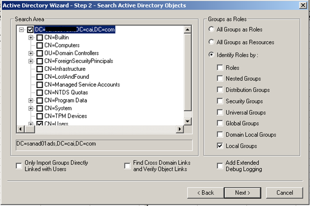

3) In the next window, select the OUs where the accounts are located or the root to search in all containers
Click Next

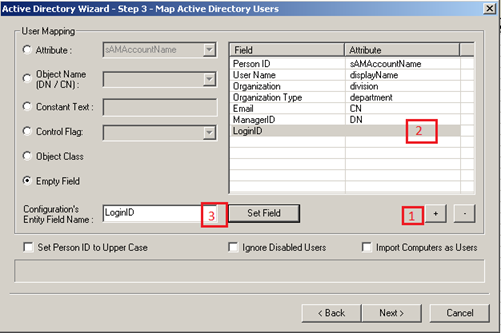

) In this window, we will create a new Field which will be used to configure the DOMAIN\Account configuration in your Universe
1 – Click + button to add a new field
2 – Select the new field
3 – Type LoginID in “Configuration’s Entity Field Name” field and click Set Field button
Click Next button

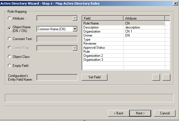

5) In the next window, you can set up the Roles
Click Next

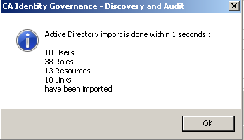

8) The next window will display the number of Users, Roles, and Resources imported

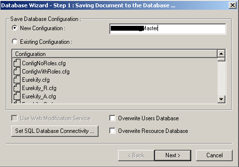

10) Let’s save the Master and Model to the Database for this configuration
1 – Menu > File > Save to Database
2 – Select New Configuration and type the Master name, click Next
3 – Repeat step #1 and #2 but now, type your configuration name _Model

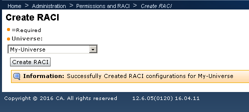

Run the Create RACI for your Universe

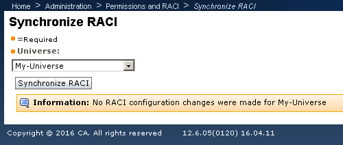

Run the Synchronize RACI

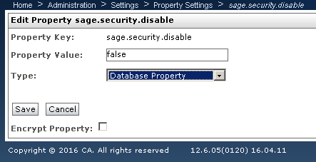

15) With this configuration done we can enable AD Authentication, below the Properties you need to change to enable AD Authentication.
Set the following properties through the Identity Governance Portal under Administration=> Settings => Properties Settings:
  • security.disable = false
  • security.disable.ADAuthentication = false

Note: For all properties above, change the Property Value and after that change the Type to Database Property as displayed below, and click the Save button.
Now, Log out and Log in with your Active Directory user using Domain\User
