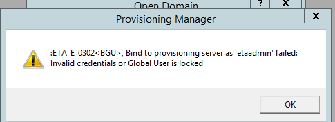

Unable to connect to the Provisioning Server through Provisioning Manager - Bind to provisioning server as 'etaadmin' failed: Invalid credentials or Global User is locked.
(02/07/2020 10:32:41 PM), Install, com.ca.etrust.install.admin.VerifyAdminServer, err, ProductException: (error code = 200; message="Java error"; exception = [ProductException: (error code = -1; message="Cannot bind to IM Provisioning Server with Global User Credentials. See previous log messages for the cause of the failure.")])
STACK_TRACE: 12
Release : 14.x
Component : IdentityMinder(Identity Manager)
Attempt to log into the provisioning server via an LDAP browser such as Jxplorer and confirm that your credentials are in fact correct.
Bind: eTGlobalUserName=etaadmin,eTGlobalUserContainerName=Global Users,eTNamespaceName=CommonObjects,dc=im,dc=eta
PW: Shared Secret
Host: IMPS HostName
Port: 20389
If they are incorrect and this is a new install then you will need to uninstall and reinstall the IMPS. This will make sure that it lays down the proper registry keys, shared secrets and creates your administrator.
If this is an existing system, then you will need to connect to through your DSA's shared secret and modify the etaadmin user's password and or enabled state (eTSuspended=0
eTPasswordChangeMaximumDays=0, and eTLocked should not be set to any value).
Bind: eTDSAContainerName=DSAs,eTNamespaceName=CommonObjects,dc=etadb
PW: Shared Secret
Host: IMPS HostName
Port: 20391
