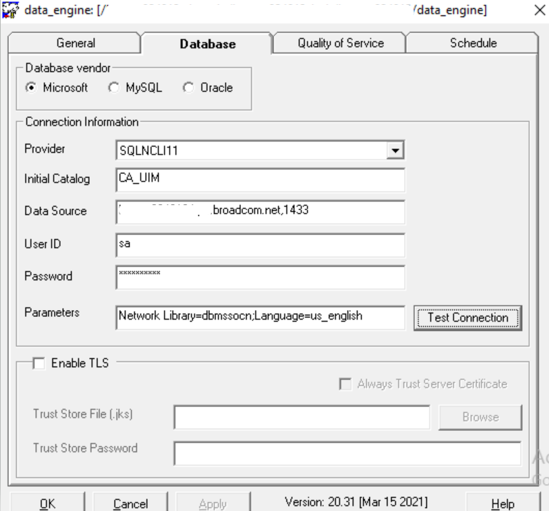

  1. On the IM go to the primary hub
  2. Select the data_engine probe
  3. Select the database tab
  4. Verify the database connection information are correct
  5. Make sure the port is added with the server information as the format below:
    Server\Named Instance,<port number>
    or
    Fully.Qualified.Domain.Name,<port number>
  6. Run "test connection" and make sure the test results as below:
    test connection DONE - result:
    Connected: yes
    Ping: yes
  7. proceed with the upgrade.
