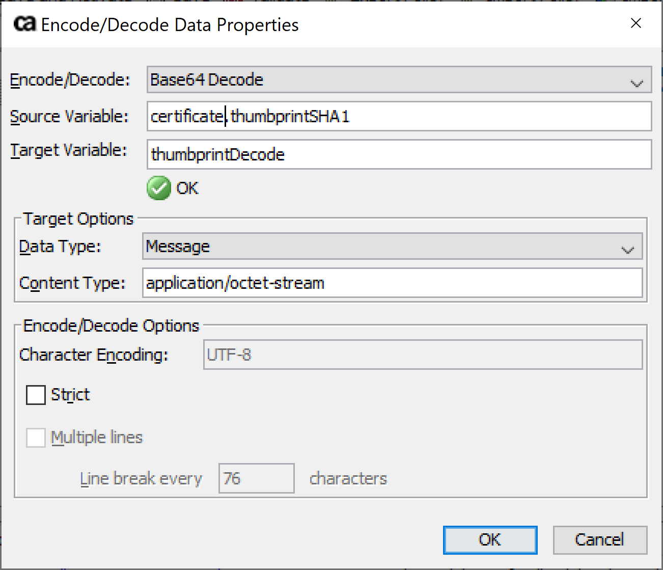

The base64 encoded value will need to be decoded as an octet-stream using the Encode/Decode Data assertion.
Once this value is obtained it can then be hex-encoded using the same assertion as seen below.
