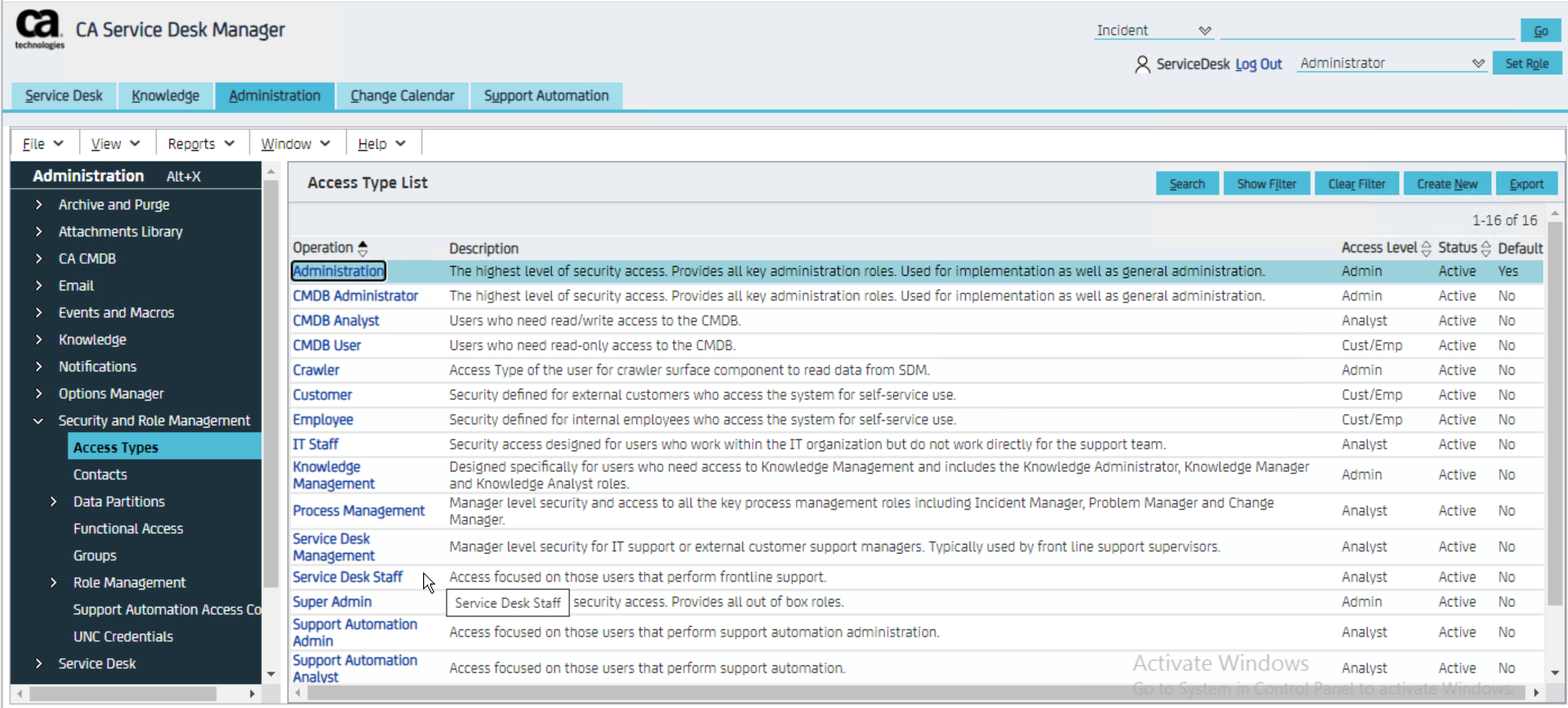

  2. Click on the ADMINISTRATION tab and navigate to SECURITY AND ROLE MANAGEMENT -> ACCESS TYPES and click on an ACCESS TYPE (i.e. Service Desk Staff) as shown in Figure 1.
    Figure 1

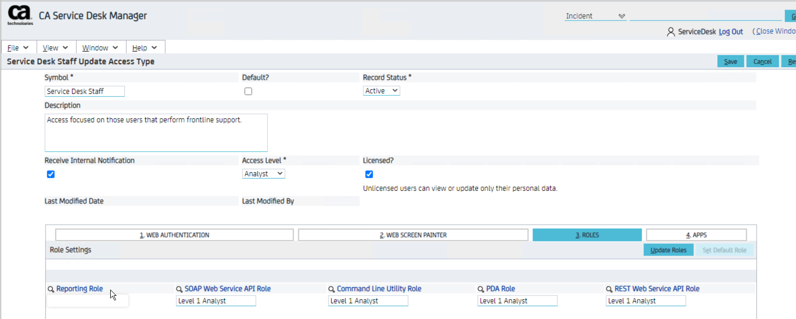

  3. Click on the EDIT button
  4. Click on the '3. Roles' tab and click on the REPORTING ROLE title to bring up the Role lookup form as shown in Figure 2.
    Figure 2

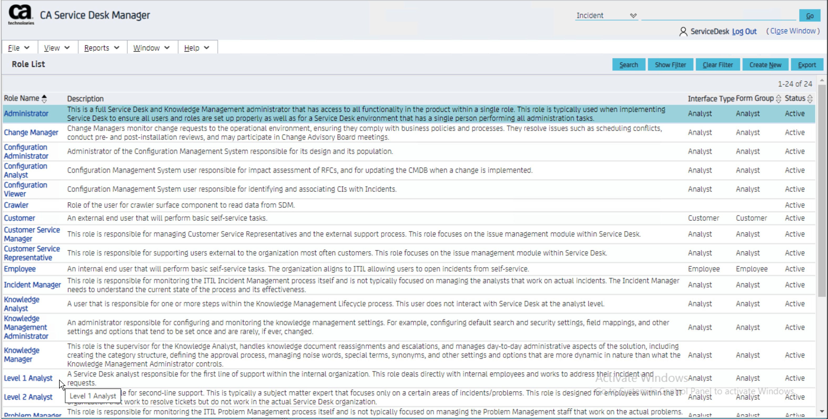

  5. Click SEARCH select a Role from the search results (i.e. Level 1 Analyst) as shown in Figure 3.
    Figure 3

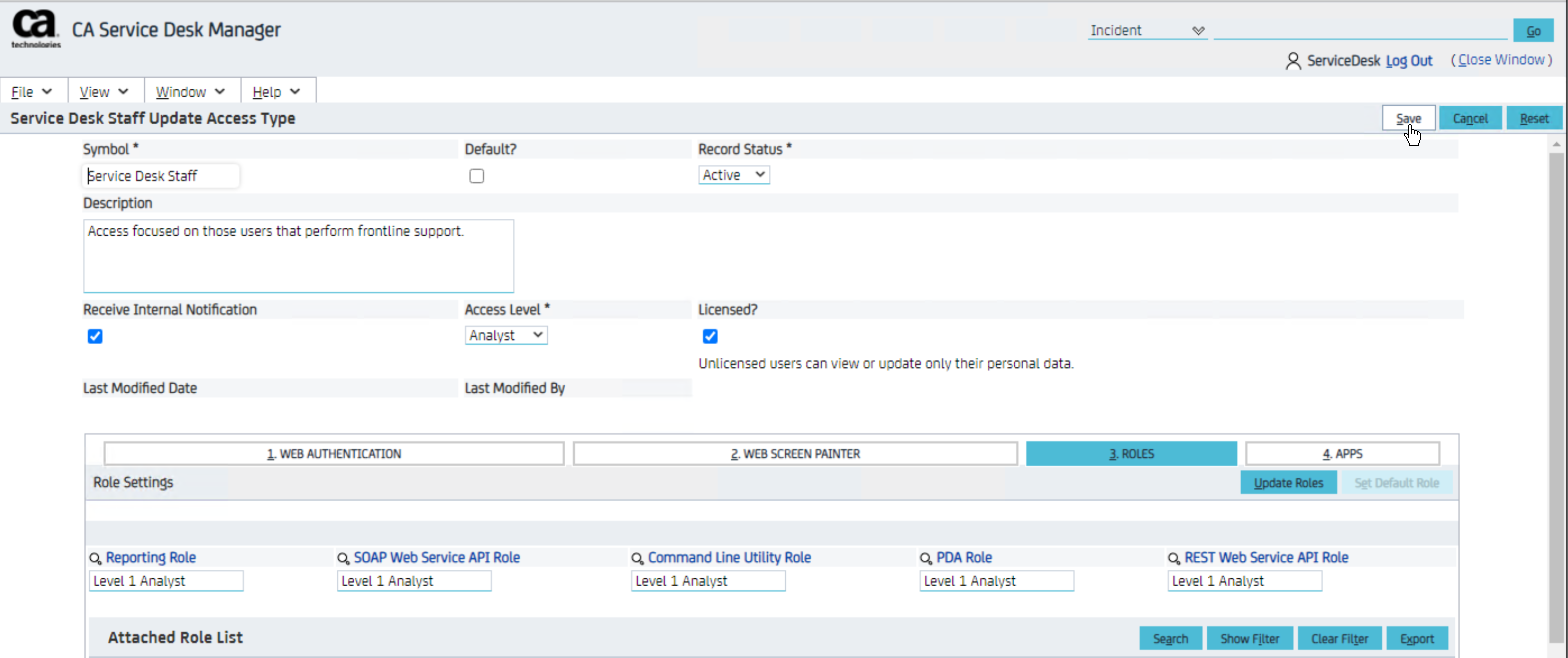

  6. Click SAVE as shown in Figure 4.
    Figure 4.
  7. Attempt to run a summary/detail report with a contact that has the Access Type just modified.
