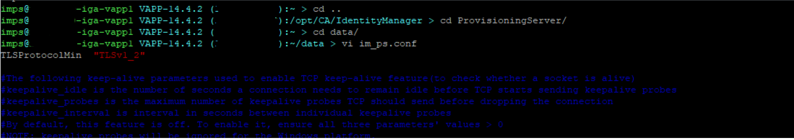

FOR VIRTUAL APPLIANCE
To adjust these files in a VAPP environment you will need to log into the SSH console as the 'config' user, then su to the imps user:
Then us an editing software such as VI to edit the specified files.
