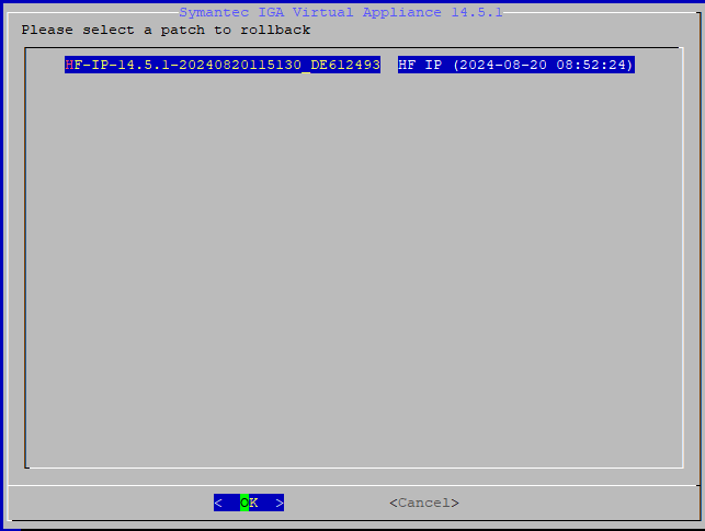

This information can be gathered from the vApp ssh console with the 'rollback_vapp' alias:
This will return a list of all currently applied fixes that can be rolled back:
Select Cancel to close the rollback process.
