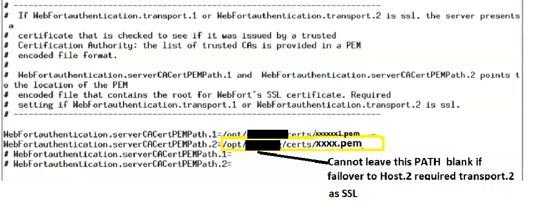

Missing fail over related parameters in arcotafm.properties.
Examine the arcotafm.log (in Debug mode) where the missing parameter will be called out. In the screen shot below the missing path to the SSL certificate is called out in the arcotafm.log.
