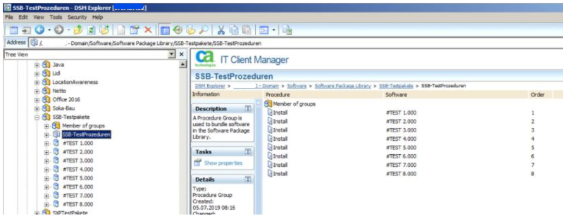

On domain manager create a test package procedure group . For Example you can see procedure group with 1-8

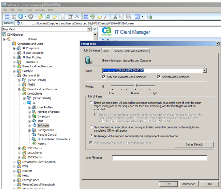

Copy and paste the procedure group on agent machine. Select No Linkage .

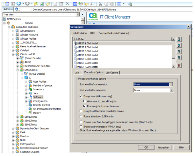

Prompt User at Package 1 and 8  .

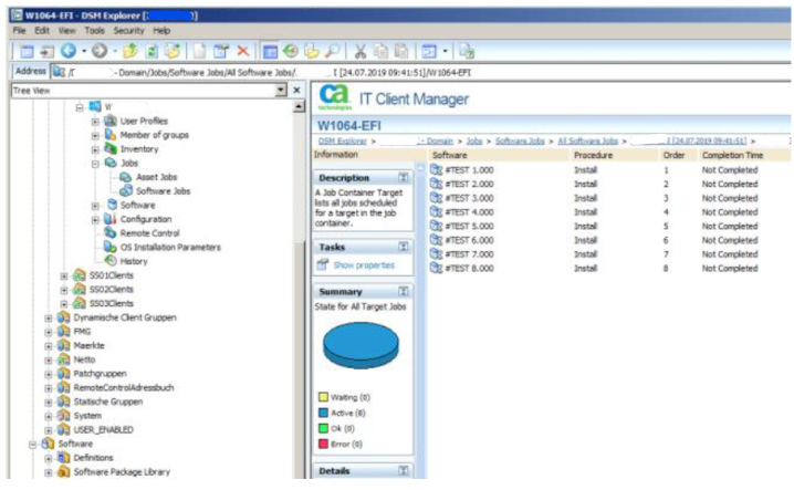

At agent job starts with Procedure 1. The job are executed as expected .

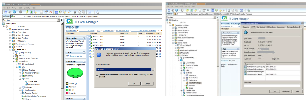

Now change to other Scalability server :
Deploy same procedure group again after changing to other scalability server. Job container get created but on agent execution shows wrong sequence as shown below
Try this job deployment multiple time . Every time it will show different sequence and it will ignore prompt with Procedure 1 and 8.
