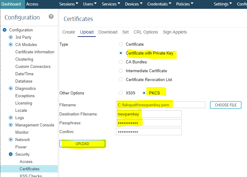

Firstly, PAM side certificate setting is here.
Once you have imported(or generated in PAM) a keypair, it would appear in this dropdown menu.
Select the new keypair certificate and click "Save Configuration".

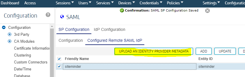

IDP Side Certificate is at the "Configured Remote SAML IdP" tab.
Select the respective IdP and click "UPDATE" button.

2. Import(or Generate New in PAM) a new keypair to PAM and import the same to other PAM nodes with Exact Same Filename.
!! You will need to export this new keypair (Download the newpamkey.crt and newpamkey.key in this example) and merge it to a single file and import it to all other PAM nodes with EXACT SAME FILENAME!!!
3. At the "Configuration --> Security --> SAML --> SP Configuration --> Configuration --> Certificate Key Pair", select the new keypair from dropdown menu and click "SAVE CONFIGURATION"
4. Navigate to "Configured Remote SAML IdP" tab and select the respective IdP.
5. Click on "DOWNLOAD METADATA" and save the xml file.
6. Provide this xml file to the IdP side person so they can import it to their federation application.
7. IdP side person will also provide an XML file (aka Metadata) which contains the updated certificate.
8. Upload the metadata xml file received from IdP to PAM.
Once this is done you can click on the "TEST" button to see if the federation still works with the new certificate.
!! You must TEST on all PAM nodes to ensure all nodes are able to login using SAML !!
