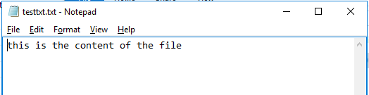

2.- Open TXT file and add any text to it:
