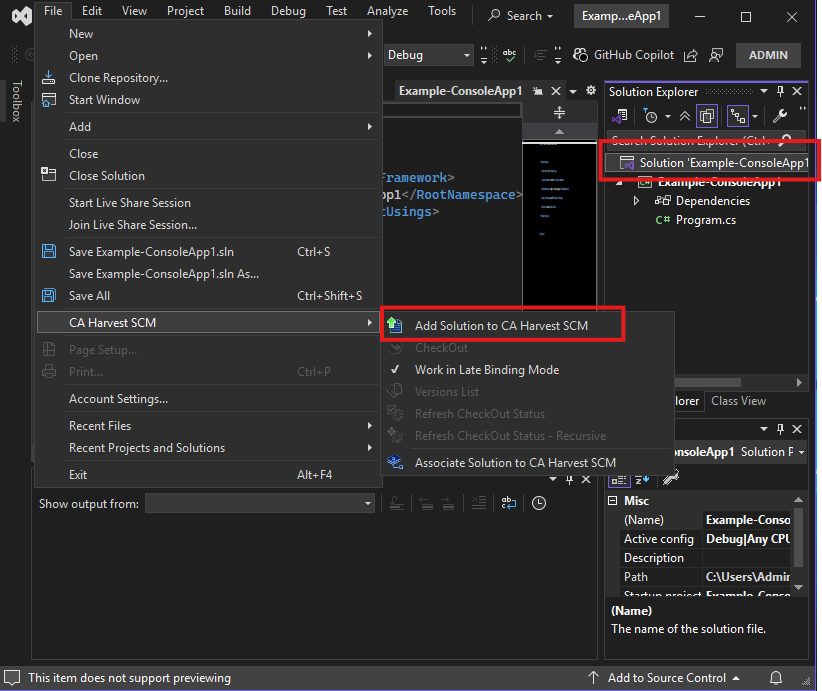

In Visual Studio the "Add Solution to CA Harvest SCM" is disabled (greyed out).
Harvest Software Change Manager v12.5 and higher
Visual Studio Plugin
The "Add Solution to CA Harvest SCM" process is a solution level process.
First, highlight the solution in the Solution Explorer, then navigate to File -> CA Harvest SCM, now the "Add Solution to CA Harvest SCM" is enabled.
