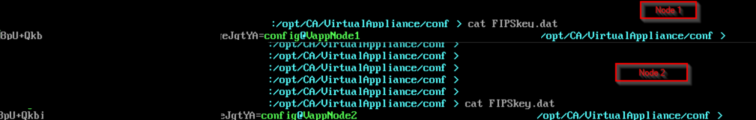

  1. Compare the FIPSKey.dat file from the working node to the non working node.
  2. If the keys are different copy the FIPSKey.dat file from the working node to the non working node
  3. Reboot the non working server
Shown below the FIPs keys must match
