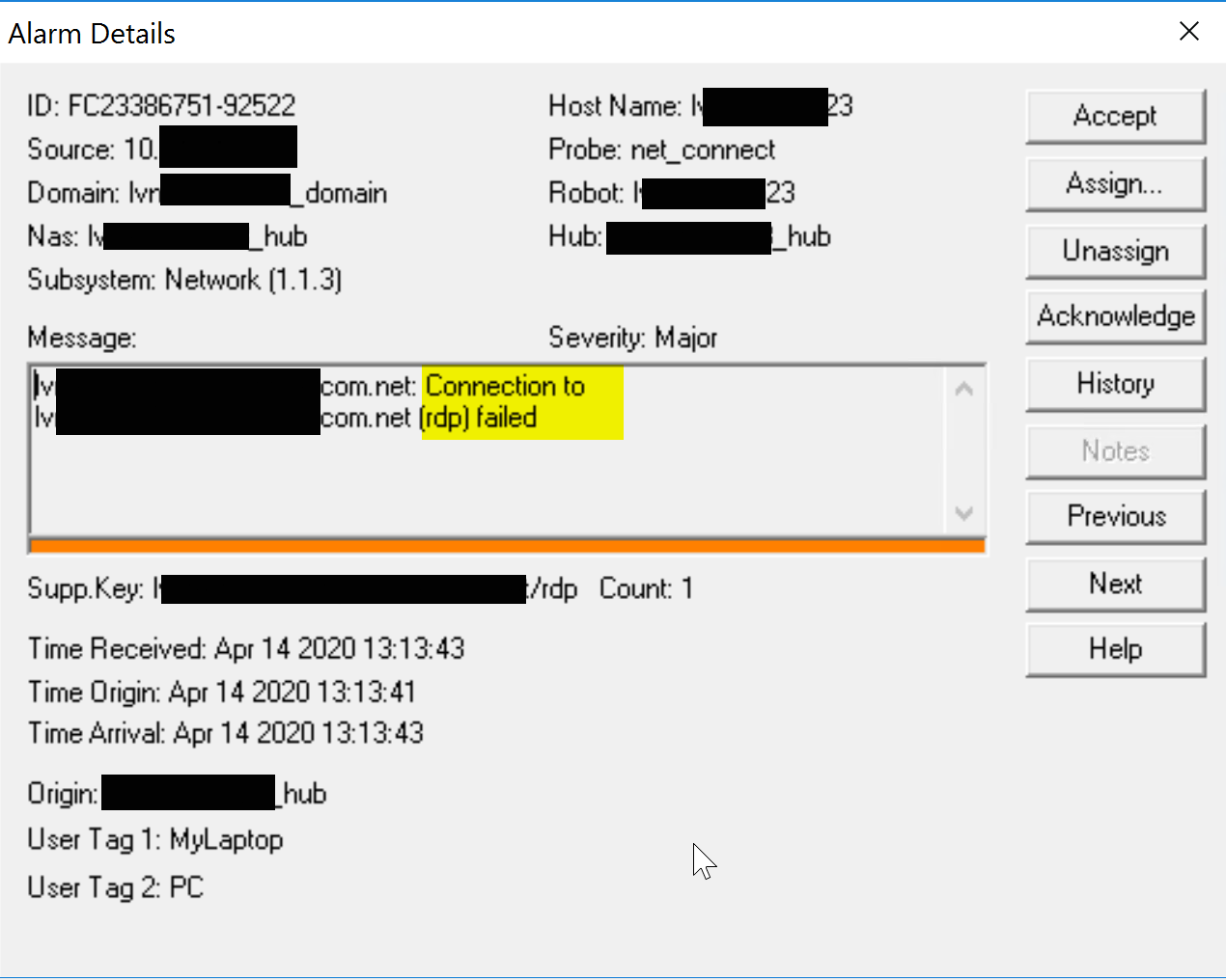

How to test the results:
You can test whether or not you get an alarm to confirm its working.
Deactivate the service and you should receive the alarm from net_connect for the service being down.
