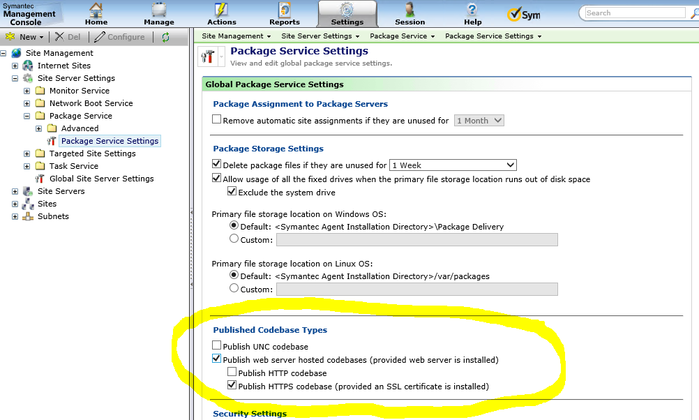

In this particular scenario, the customer had configured under Site Server Settings these package servers to only provide HTTPS codebase. UNC and HTTP were off.
On those package servers, in the IIS manager, there was a binding for port 443 but no certificate was assigned to it.
In order for the Package Server agent to provide the proper codebase references, IIS needs to be configured with the necessary references.
In this case, assigning the proper certificate fixed the issue.
If only HTTPS codebases are setup to be provided, make sure the binding for port 443 has a valid certificate in IIS Manager for the Site Server.
