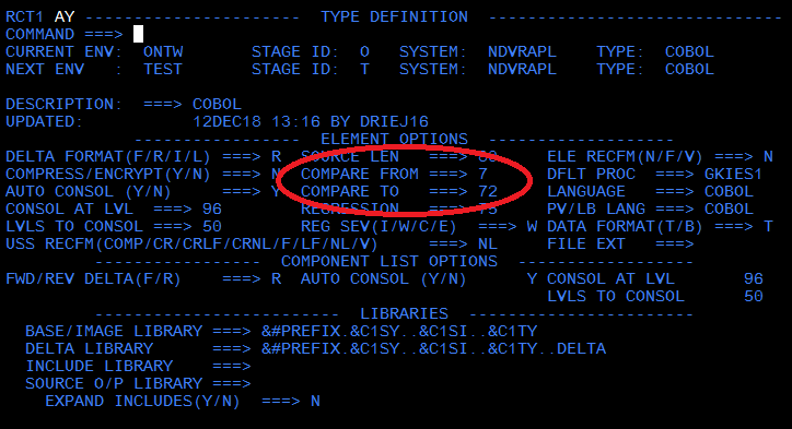

When changing line(s) of code from in element of Endevor, sometimes the level version is not showing the change.
Release : 18.0
Component : CA Endevor Software Change Manager
Working as designed.
It's possible to see this behavior when you have set the parameters 'COMPARE FROM' and 'COMPARE TO' with an interval that is not cover the change of the code.
Example:
Under the scenario in the image, all modifications that are not between 7 and 72 endevor will not cover it.
So if a change in line 6 it's performed, endevor will not show that change in the level versions.
