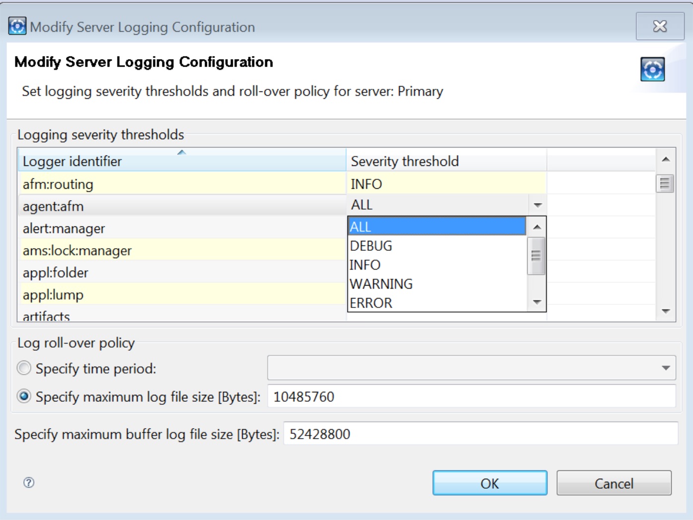

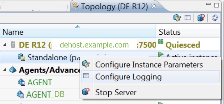

Go to Topology -> Configure Logging
Change these three settings from WARN or INFO to ALL
agent:afm (default WARN)
communications (default INFO)
dm:communications (default INFO)
The changes take effect immediately. Collect the logs for about an hour, then revert back to your previous or default logging.  Get the IP addresses from tracelog and then connect to the host and shut them down if desired.
