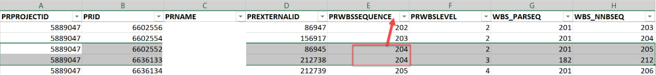

There is a second scenario where a sequence number may be used more than once.
For example:
In this example, we would want to reset the sequence number "prwbssequence" column for both rows.
Sample Update statements:
update prtask set prwbslevel =1 where prid = 6636133;
update prtask set prwbslevel =1 where prid = 6602552;
update prtask set WBS_NNBSEQ = 1 where prid = 6602552;
update prtask set WBS_NNBSEQ = 2 where prid = 6636133;
