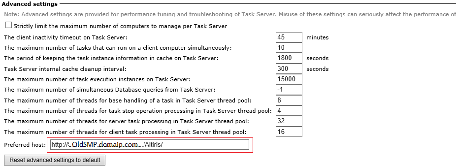

In this particular scenario, there was a manual reference for the "PreferredNSHost" under the Task Service Setting on the new SMP (since they migrated the same database to the new server) that was still referencing the old SMP. That is why the error message was saying that these Task Servers were trying to register to the SMP 8.1 rather than the SMP 8.5.

ITMS 8.5 and earlier:
  1. On the SMP server open ".\Program Files\Altiris\Notification Server\bin\Tools\NSConfigurator.exe"
  2. Search for TaskServiceAdvancedSettingsAllowed. Enable the setting and save (set it to "True").
  3. In the SMP Console go to "Settings > Notification Server > Site Server Settings > Task Service > Settings".  Select the policy that targets the problem Tasks Server.
  4. The Advanced Settings page should be visible. Look near the bottom for the "Preferred host" box and verify the name of the server is the current SMP and not another one.  If it is incorrect make the necessary changes and save it.
  5. On the Task Server open "Services Manager" and restart the "Altiris Client Task Data Loader" service
  6. Open the Symantec Management Agent UI and click on the Update Configuration button.
