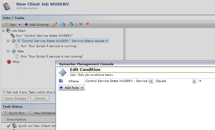

This article walks you through creating a Job that includes a Control Service State task as you want to do one of two things based on the status returned from the "Get Status" action.
ITMS 8.x
  1. Create a new Control Service State task.
    • Enter the service name
    • Set Action to Get Status
  2. Create a new job
    • Add Control Service State task
    • Highlight the task and select New > condition
    • Set the first Where drop-down to <name of control service state task>-Service Status
    • Set the second one to desired condition operator, equals for this example
    • Set the third field to 4 for running, 1 for stopped, or per below list as needed and click OK
  3. Highlight the If line and add desired task; repeat for the Else line
