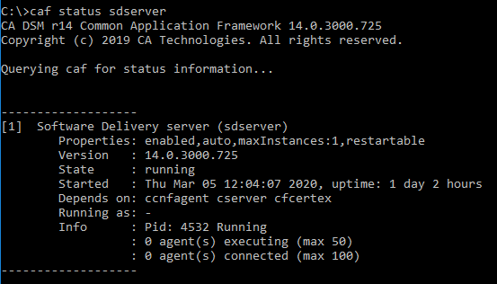

Here it's explained how to check the current number of Agents connected to a particular SS while a SD job is being executed.
Client Automation - All versions
Command "caf status sdserver" returns the number of SD agents executing a SD job and number of SD agents connected
Info : Pid: 4532 Running : 0 agent(s) executing (max 50) : 0 agent(s) connected (max 100)
