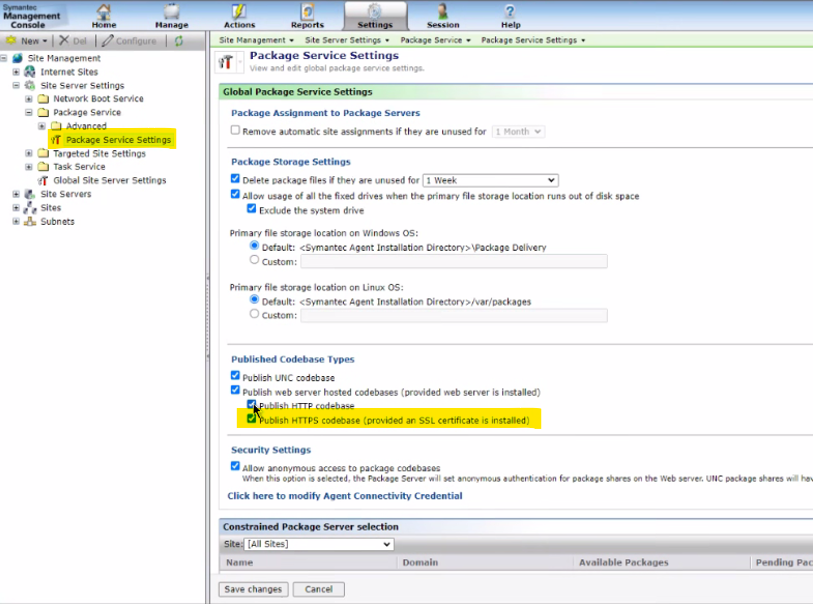

UNC and HTTP paths were given, which doesn't work on CEM mode. We are expecting HTTPS links to be available.
We modified the HTTP link (to be HTTPS) and tried it from the actual gateway and it worked (we were able to access the page):
https://<Servername>:4726/Altiris/PS/getpackagesnapshot.asp?Resource={36800A20-2EBF-4EFA-A216-C730147650C7}&PackageId={04ABEC0D-13FB-4DB6-9A3E-F9DB0C776583}&compress=1
Reviewed the Internet Site Server configuration under Site Server Settings and we noticed that the "Global Package Service Settings" didn't have "Publish HTTPS codebase (provided an SSL certificate is installed)" option selected for Published Codebase Types.
After selecting that option and requesting a new configuration on that Site Server, the desired packages started downloading just fine.
