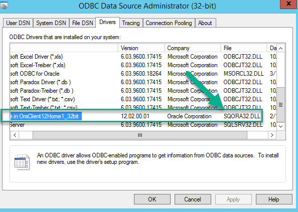

1- Install oracle 12.x 32 bit client including ODBC drivers
2- Validate the Oracle driver appears in the windows 32 bit ODBC administrator

4- Run the following command against the name of your file:
C:\Program Files (x86)\Nimsoft\sdk\nsa>nsa -d 5 example-oracle-operations.txt
Mar  2 11:11:44:861 nsa: SNMP Initialize, version 223 (5.7a), build date Mar 17 2015
Mar  2 11:11:44:861 nsa: SNMPInitialize - initializing critical sections
Mar  2 11:11:44:861 nsa: SNMPInitialize - initializing logging
logging:register: registering log type 5 with pri 7
Log handling defined - disabling stderr
Mar  2 11:11:44:877 nsa: registering logging callback at address: 0x411320
Mar  2 11:11:44:877 nsa: SNMPInitialize - calling init_snmp
Mar  2 11:11:44:893 nsa: ===> Starting: example-oracle-operations.txt
Start database connection 1
Driver={Oracle in OraClient12Home1_32bit};Dbq=//xxxxxxxx:1521/xxxxxxx;Uid=system;Pwd=nimsoft
Mar  2 11:11:44:893 nsa: [0x00837B90] Database provider is 'N/A', database 'N/A'
0
Number of QoS objects: 3
Name Column has: lvntest009204, CS_ID Column has: 3
Name Column has: lvntest009203, CS_ID Column has: 2
Name Column has: primaryrobot, CS_ID Column has: 1
Mar  2 11:11:45:158 nsa: ===> Completed: OK
