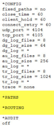

CAMSAVE EXPLICIT
  • Generates the file %CAI_MSQ%\cam.cfg with parameters in section *CONFIG which are used by the cam.exe process
  • Paths and Routing section will be left blank.
NOTE: Since "camsave explicit" creates a cam.cfg file, if there is already present, any lines in *PATHS and/or *ROUTING will be removed.

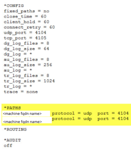

CAMSAVE PERSIST
  • Also populates the Paths and Routing with any machines that are connected at the time the command is executed
  • Since UDP is the default protocol, agents that are showing to use UDP do not need to be in the cam.cfg file, only agents that show using TCP 4105
NOTE: Since it does populate all machines that are connected at the time the command is executed, this command has been known to freeze and create a corrupted CAM.CFG file
CAMSAVE CONFIG
  • Generates the file %CAI_MSQ%\save.cfg with parameters in section *CONFIG
  • Also populates the Paths and Routing with any machines that is connected at the time the command is executed
NOTE: Since this files does not create a cam.cfg file, but instead a save.cfg file, it is less likely to have an issue when creating it, but you will have to rename the save.cfg file to cam.cfg when done
