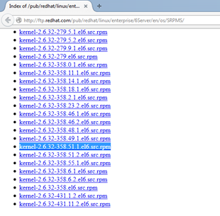

  1. Download the kernel source code package
    Use the URL that follows to download the kernel source code
    http://ftp.redhat.com/pub/redhat/linux/enterprise/6Server/en/os/SRPMS/kernel-2.6.32-358.51.1.el6.src.rpm

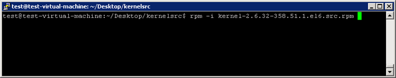

  2. Install source package
    Execute the commands that follow from the terminal in current user’s home directory:
    mkdir -p rpmbuild/{BUILD,RPMS,SOURCES,SPECS,SRPMS}

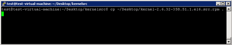

    Now change directory to where kernel source rpm is present and execute below command
    echo "%_topdir $(pwd)/rpmbuild" > ~/.rpmmacros   rpm –i kernel-2.6.32-358.51.1.el6.src.rpm
    If you get “cpio: MD5 sum mismatch” error then use below command
    rpm --nomd5 -i kernel-2.6.32-358.51.1.el6.src.rpm
    This will extract all the required source files from the package to the “rpmbuild/SOURCES” folder under current user’s home directory.

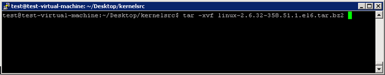

  3. Extract source code from the package
    Copy linux-2.6.32-358.51.1.el6.tar.bz2 to some other folder
    Now extract its contents
    tar –xvf linux-2.6.32-358.51.1.el6.tar.bz2

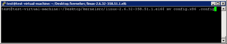

  4. Copy the config file to the extracted location
    “Config.x86” file is located on NS at below location
    <InstallDir>\Altiris\Deployment\BDC\bootwiz\Platforms\Linux\x86\Build
  5. Execute “make oldconfig"

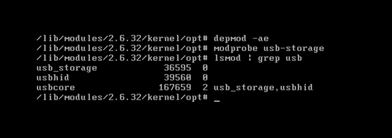

Loading Driver in Linux Preboot ( LinPE )
  1. Driver can be loaded into Linux Preboot using following commands:
    Create opt/ folder under /lib/modules/2.6.32/kernel/
    And copy driver file ( .ko ) to Linux Preboot (eg. /lib/modules/2.6.32/kernel/opt/ )
  2. Navigate to the directory where the driver is copied.
  3. Execute depmod –ae
  4. Execute modprobe <dirvername> ( eg modprobe usb-storage)
