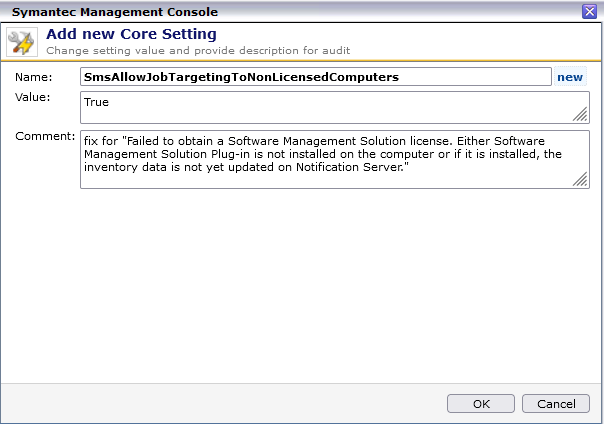

  • This functionality is not available out of the box and not enabled by default. You must enable it manually by setting the following coreconfig as explained below.
For 8.5 and newer versions:
  • Settings> Notification Server> Core Settings
  • Then right click on the '+' button to 'Add New Core Settings'
  • Create the following core settings and test again
    • SmsAllowJobTargetingToNonLicensedComputers  Value: True
