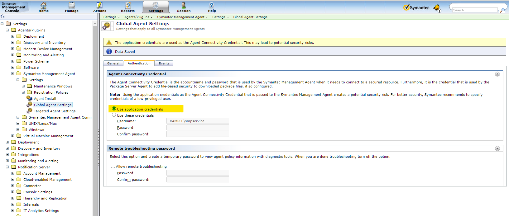

If step 2 is successful, there may be an issue with the Agent Connectivity Credential as specified. If the Account is on a Domain, the Domain must be referenced. i.e. Domain\UserName
