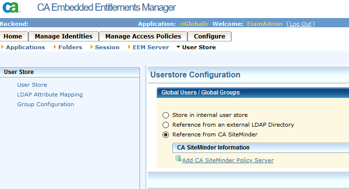

To utilize SiteMinder Single Sign-On with IT Process Automation, EEM must be configured to point to the CA SiteMinder Policy Server objects using the reference from CA the SiteMinder Userstore Configuration option.
To configure CA EEM server to point to CA SiteMinder Policy Server objects, access the CA EEM Administrator UI.
