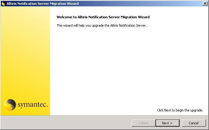

Welcome Page
This is the welcome page for the upgrade wizard.

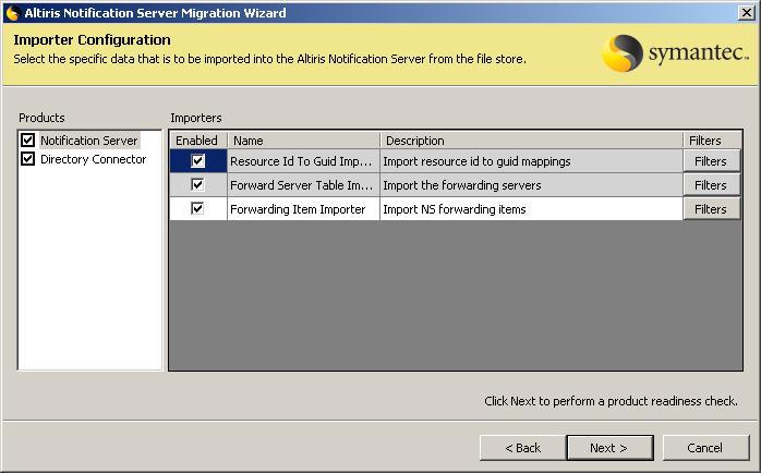

Importer Configuration Page
Use this page to specify the importer configuration options. This page is displayed only when importing data from the data store.
This page allows the user to refine what data is to be imported into the Notification Server.
Options
  • Products. This lists the supported products that can import data. Each list entry corresponds to a product configuration file. A product and all of its importers can be excluded from the import process by unchecking the product's checkbox.
  • Importers. This lists the available importers for the selected product that can import data. An importer can be excluded from the import process by unchecking the importer's checkbox.
The Filters button for each importer will display the Filters dialog, which displays the available filters for that importer. This dialog allows a user to further refine what data the particular importer will import.

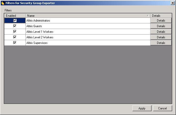

Filters Dialog
This dialog displays the available filters for the selected exporter or importer.
Options
  • Filters. This lists the available filters for the selected exporter or importer. A filter can be excluded from the export/import process by unchecking the filter's checkbox.
The Details button for each filter will display the Filter Details dialog, which displays more information about the selected filter.

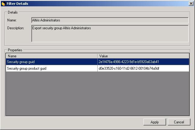

Filter Details Dialog
This dialog displays information about the selected filter.
Options
  • Name. The name of the filter.
  • Description. The filter's description.
  • Properties. This lists other properties that describe the filter. The properties that are listed here are those properties on the filter that have the FilterPropertyAttribute.

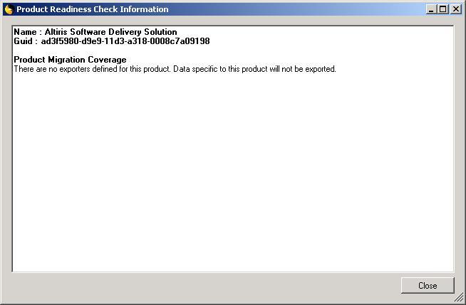

Product Readiness Page
This page displays the product readiness status of the machine that the migration is run on.
This page displays the following information:
  • Solution migration baseline. The wizard will check that the solutions that are to be migrated meet the minimum baseline requirements. The wizard will use the supported products defined in the product's upgrade configuration file and the SupportedProduct attribute on the exporter/importer types to determine if the minimum baseline requirements have been met. It will display information detailing which installed solutions do not meet the minimum requirements.
  • Solution migration coverage. The wizard will check that all the installed solutions have a valid migration path. If a solution is installed but does not have any exporters defined, a message will be displayed. This is to notify the user that data for this solution will not be exported. During the solution migration coverage check, the wizard will ignore any product that is marked as unsupported in the product's upgrade configuration file. This is so that any products that are end-of-life and cannot be migrated do not show up in the migration coverage check.
Note: The user will still be able to continue with the migration process even if there are product readiness failures.
Product Readiness Information Dialog
This dialog displays information describing why a particular readiness check has failed.

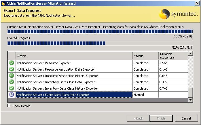

Export / Import Progress Page
This page displays the progress of the export or import operation.
Options
  • Current Task. This displays the name and the progress of the current task.
  • Overall Progress. This displays the overall progress of the export/import.
  • Show Details. This option will display more details about the export/import.
