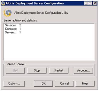

The GSS Performance Related Settings are found in the Deployment Server's Configuration Control Panel applet.
To open the Configuration applet, navigate to Control Panel and open the Altiris Deployment Server (32-bit) as shown here:
Then select Options as shown here and under the General tab you'll see the following:

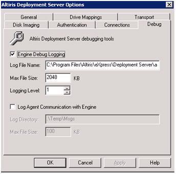

 Under the Debug tab you'll see the following:
  • Engine debug logging:  Increases engine overhead due to cycles being spent on logging activities.  This setting should be disabled unless support is requesting logs.

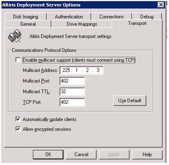

Under the Transport tab you'll see the following:
  • Allow encrypted sessions:  Allows agents configured to encrypt communications with the DS to securely communicate with the DS.  This setting increases overhead on the DS Engine and should only be used when absolutely necessary.
