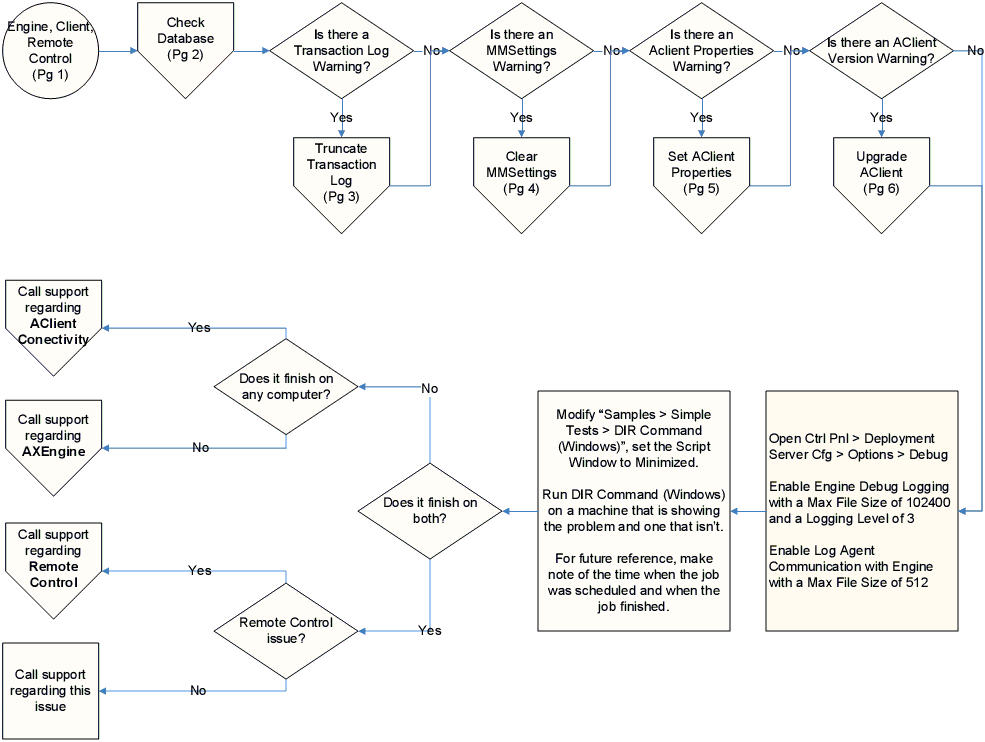

A VBscript (HowTo9089.vbs) has been attached to this article and will aid in the troubleshooting process. The script must be run on the Ghost Solution Server with the same credentials used to install GSS.  This script was designed to be ran on GSS 3.x products.  The following work flow follows the steps taken in this process:
Check Database (p. 2)
Prior to running the attached .vbs file it is necessary to edit the file and modify the connection string:
conn = "DRIVER={SQL Server};SERVER=<SQLSeverName>;DATABASE=<DatabaseName>;Trusted_connection=yes;"
Replace <SQLSeverName> with the correct SQL server name
Replace <DatabaseName> with the correct database name (default database name is eXpress)
Running the howto9089.vbs will output the following three files:
  • 4214.txt - results
  • 4214_OLD_Aclients.txt - list of clients running an old client version
  • 4214.rci - can be used with Remote Agent Installer to push new clients
How to truncate the SQL Transaction Log when it becomes too large (p. 3)

How to clear the MMSettings (p. 4)

How to set the AClient/DAgent properties (p. 5)

How to upgrade Dagent (p. 6)
