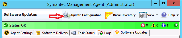

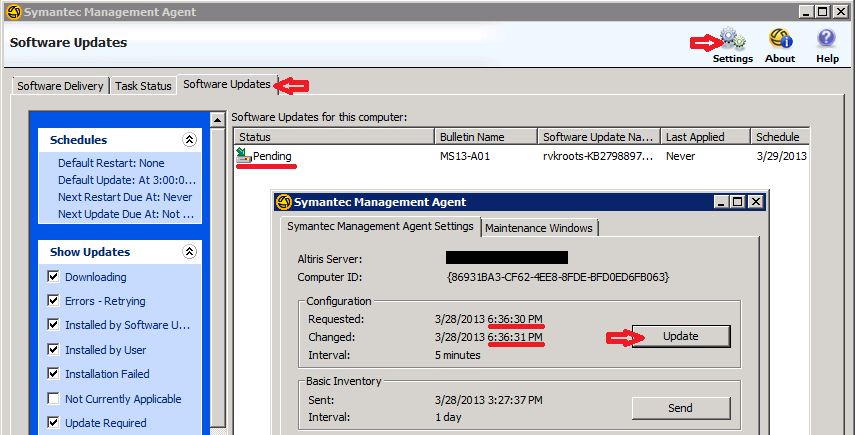

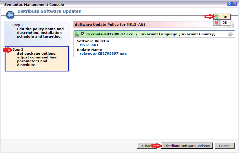

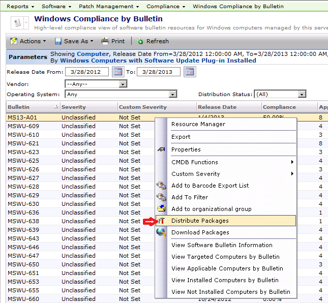

Patch Management does not run in real time; there are hidden steps in deploying patches and updating reports that run on schedules to maintain efficiency in large environments. However, these hidden steps can be manually run to accelerate the process. Every step in the process of downloading, installing, and reporting patches is detailed below. Follow these steps to identify where a patch is failing in the process or to quickly check if a new patch will deploy successfully.
“C:\Program Files\Altiris\Altiris Agent\Agents\PatchMgmtAgent\AeXPatchUtil.exe” /i
