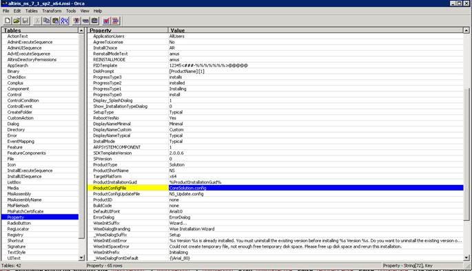

Option 2:
Another approach is to use ORCA (https://www.guidingtech.com/download-orca-msi-editor-standalone/) and use it to refer to the MSI itself. ORCA should tell you which config file calls are made when it runs the install process.
For example, the main MSI for the SMP itself is altiris_ns_7_1_sp2_x64.msi. When ORCA opens, under Properties>ProductConfigFile, you should see that it calls CoreSolution.config. However, if it is an update installation (like from SP1 to SP2), the config file called is NS_Update.config found under ProductConfigUpdateFile.
So, in this case you can run the following command line indicating the specific config file that you want:
AeXConfig.exe /configure C:\Program Files\Altiris\Notification Server\Config\CoreSolution.config
You can use ORCA to look for what config files other Solutions uses initially.
