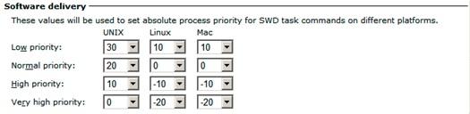

Approximate CPU usage is a configurable parameter in the NS console. These parameters affect the ‘nice’ setting of various commands running on the ULM clients. See the following screen shot.
