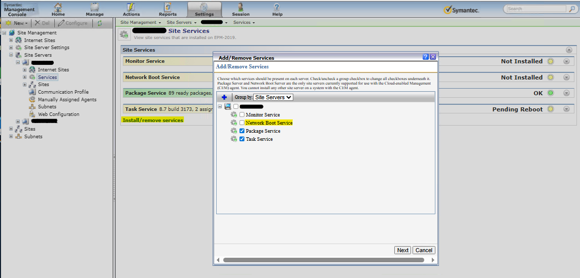

In the SMP Console under Under Settings > Notification Server > Site Server Settings > Site Servers > <Site Server> > Install/removes services you'll see:
  1. Network Boot Service -- Recommended Installation --

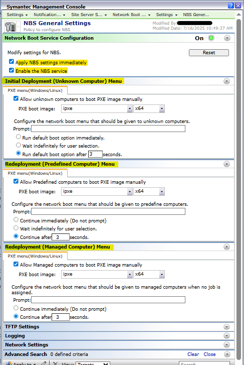

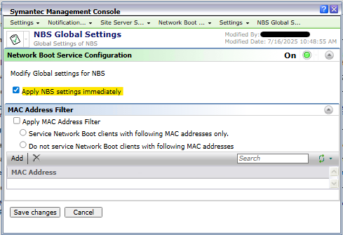

In the SMP Console under Under Settings > Deployment > NBS Global Settings you'll see the following:
  1. PXE Server Configuration  -- Recommended Enabled
    NOTE:  You must click "Save Changes" on this page in DS 8.x for this policy to be enabled correctly.  Also toggle 'Apply NBS settings immediately' within the policy

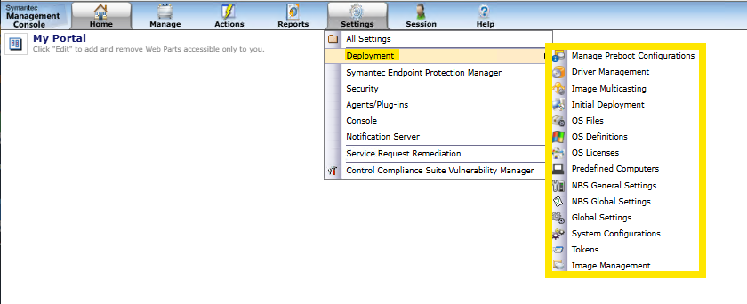

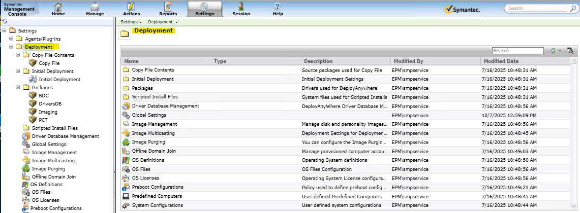

In the SMP Console under Settings > Deployment you'll see the followiing options:
In the SMP Console under Settings > All Settings > Deployment you'll see the following options:
